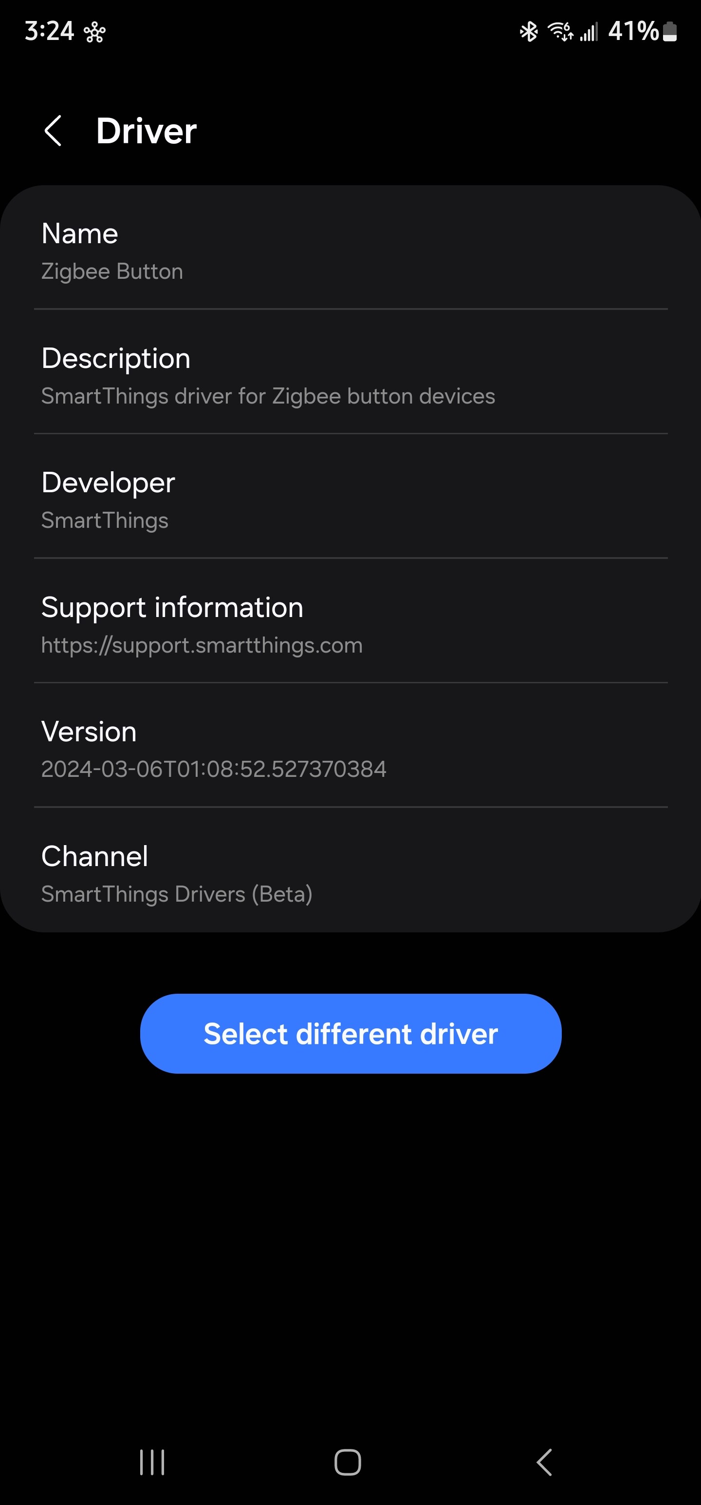

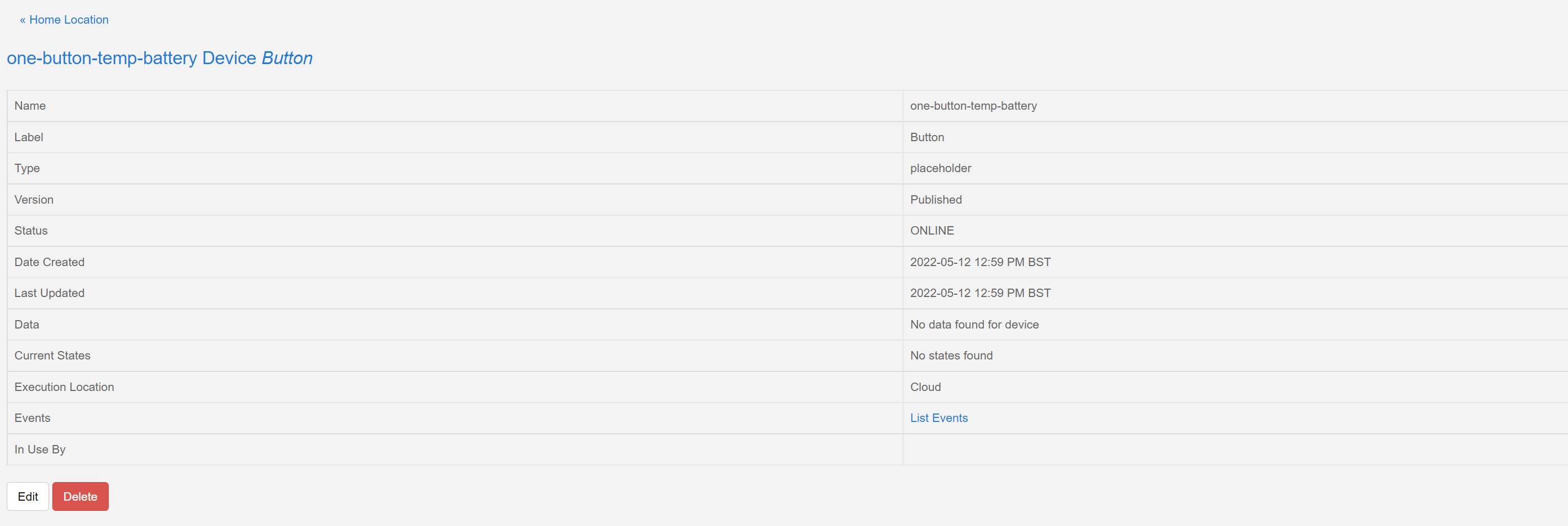

This is the result of adding Aeotec Button to the Hub. Changing the DTH to Zigbee Button is not resulting in any change. Still no events are caught. Changing the driver from mobile App is also failing with the message “Check network connection. Make sure your phone is connected to the network”. Adding the device many times… Scanning QR code and searching nearby devices. The result is always the same.

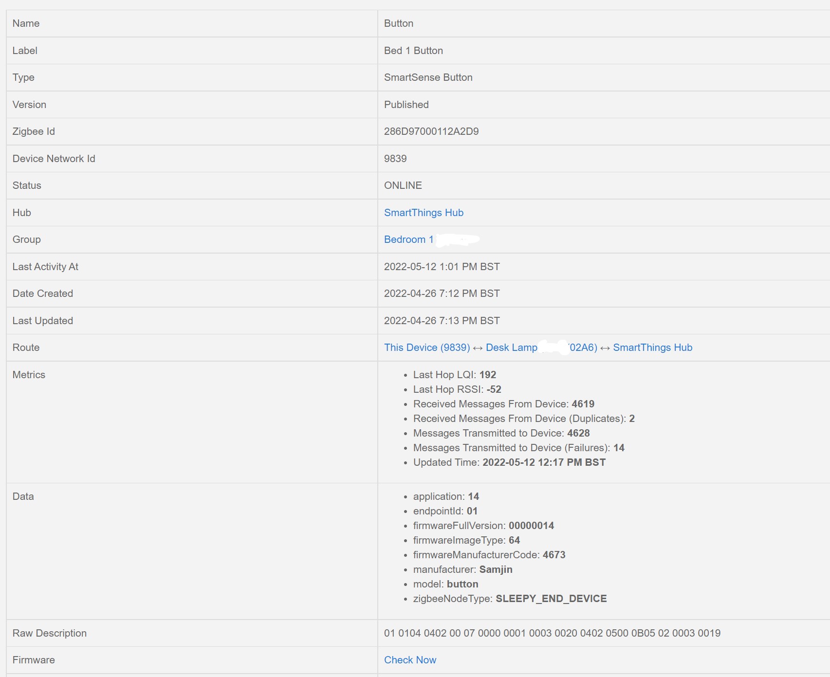

That doesn’t look right at all. I just added 2 buttons, one was just added yesterday and both are working great. Here’s what it should look like in the IDE:

ST doesn’t have an Edge driver for these yet that I know of. Did you have another Edge driver perhaps that is using the fingerprint of the button? Sounds like it me. I had the same issue adding a LUX thermostat and it picked up a Xiaomi edge driver I was testing, which tells me the developer added a fingerprint they shouldn’t have.
It looks like you’ve picked up an Edge driver forked from the stock Zigbee Water Sensor. I know @veonua has a Github repository where there is a Zigbee Water Sensor driver that has a generic fingerprint that looks like it might perhaps cause exactly this problem. Is it plausible for that to have been installed somehow?
Solved. Indeed it was related to edge driver which couldn’t be removed from beta drivers web page. I had to use smartthings CLI tool and do it from the console.

Within the past couple of days, ST has started defaulting this button to use the new Edge driver. Since the old Groovy IDE doesn’t recognize Edge properly, new buttons you join will show as placeholder with cloud execution, and won’t show any logs. They will actually have local execution though, as all Edge drivers run in your hub.
After joining one of these, don’t try to change the device type away from placeholder (I’m not sure whether doing that actually has any effect). Instead, test functionality in the app to see if the button presses are recognized properly.

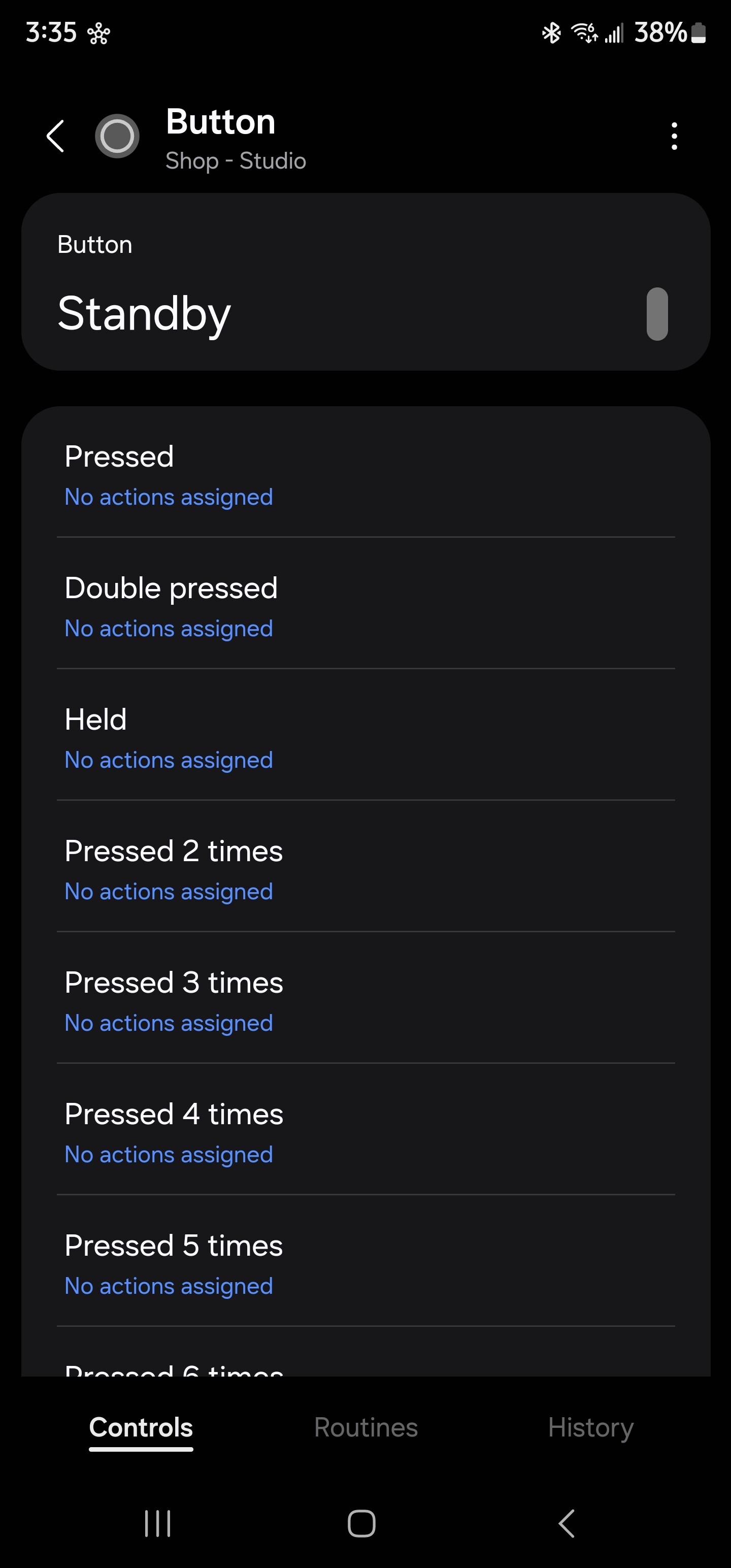

The button doesn’t work at all, nothing is recognised, to the hub, just an icon on the app that doesn’t do anything. It also has lots of different options for the button that don’t exisit, like toggle etc, temp recorded at 0.0 and batt level 0%

This should only be 3 options because its just a button. Press and double press and hold thats it and im getting no signal out of it the battery said 70 percent I just swapped it with a brand new energizer it cant be that
