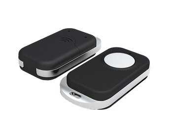

The device is spec’d to have a typical battery life of one year, or around 10 hours of actual transmission use. If you using it four times a day that’s still probably less than 30 seconds of daily transmission time.
There are a couple of things that could be causing extra transmissions, and therefore running the battery down faster.
What Messages is the device sending, and why?
