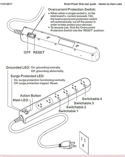

I would say yes but Im not an electrician so maybe someone else could chime in. Below is another manual I found. If the outlets still work, then it may just be the surge protection will not work any longer. I think it would be like having a normal power strip with no surge.

The protection light should be on if the surge arrestor is working properly. And the ground light should be on if the unit is properly grounded. An ungrounded surge arrestor will not provide proper protection.
Many high quality surge arrestor will actually cut the power to the load when the surge arrestor fails. That is not true of lower quality units.
