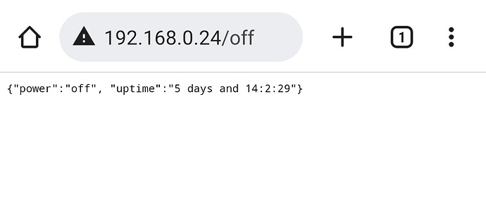

(Figure 2, showing how to turn on a SONOFF device using http command)
(Figure 3, showing how to turn off a SONOFF device using http command)
