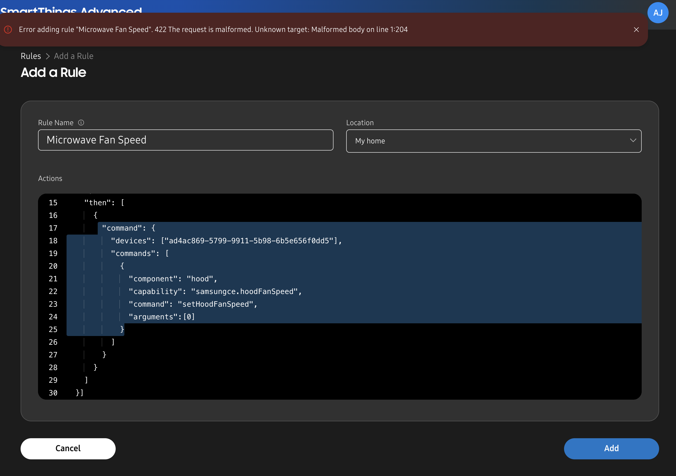

Anyone point me in the right direction? Screenshot of what i’m seeing is attached.

And am getting this new error: Error adding rule “Microwave Fan Speed”. 422 The request is malformed. then: Unrecognized field “then” (class v20190122.internal.st.behaviors.Action), not marked as ignorable

and got this: Error adding rule “Microwave Fan Speed”. 422 The request is malformed. component: Unrecognized field “component” (class v20190122.internal.st.behaviors.CommandAction), not marked as ignorable
