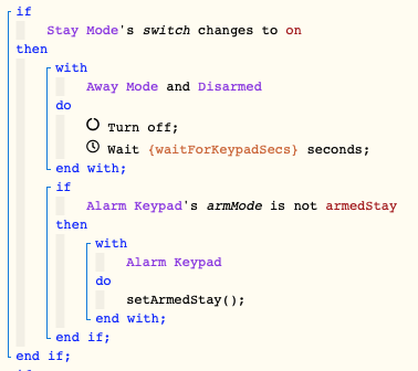

I’m using the RBoysApps: LUM(Lock User Manager), Intruder Detection, and Ring Keypad Gen 2 device handler.
I’m looking to get some suggestions around how to program this with WebCore or some other way. I have a Ring keypad Gen 2, ActionTiles, and the new STHM that I want to keep in sync. The problem is that the Ring keypad will make announcements multiple times since one thing updates another and I get this echo effect where it comes back to update the Ring Keypad. I wish I could somehow differentiate when to and when not to send it to the Ring keypad but I can’t come up with the logic on how to do this in WebCore. It’s sort of like this as they all have to update each other depending on where you make a change:
RingKeypad <-> ActionTiles <-> STHM <-> (Loop to RingKeypad)
So any time you make a change in one place, it updates everything else. The problem is that the Ring Keypad will say Disarmed 2-3 times because it’s getting those commands as the commands make their way around to ensure everything is in sync.
Any ideas how I can fix that?
