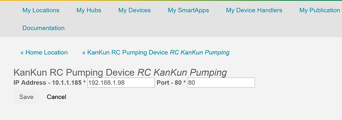

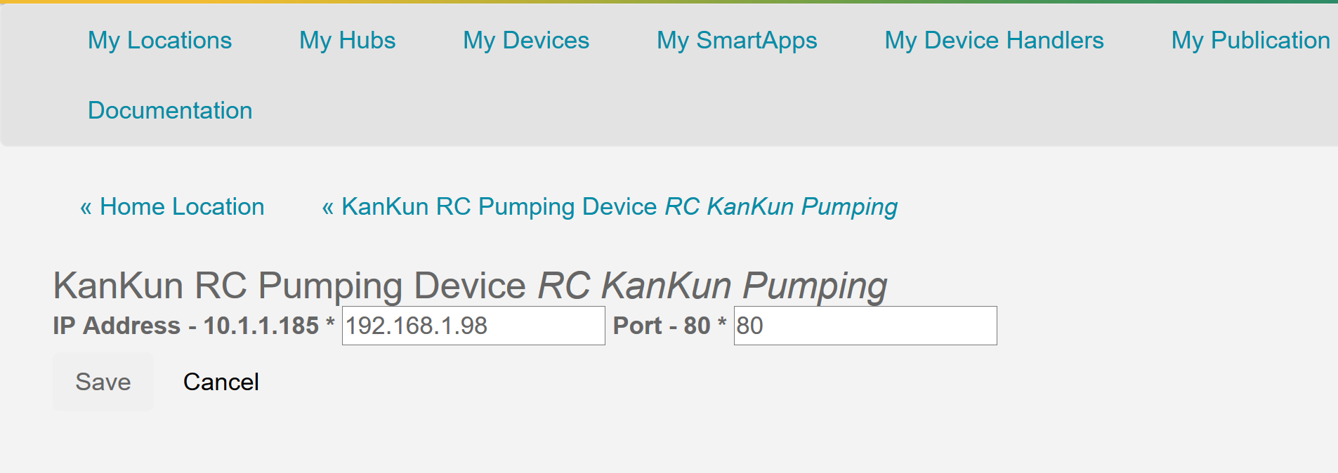

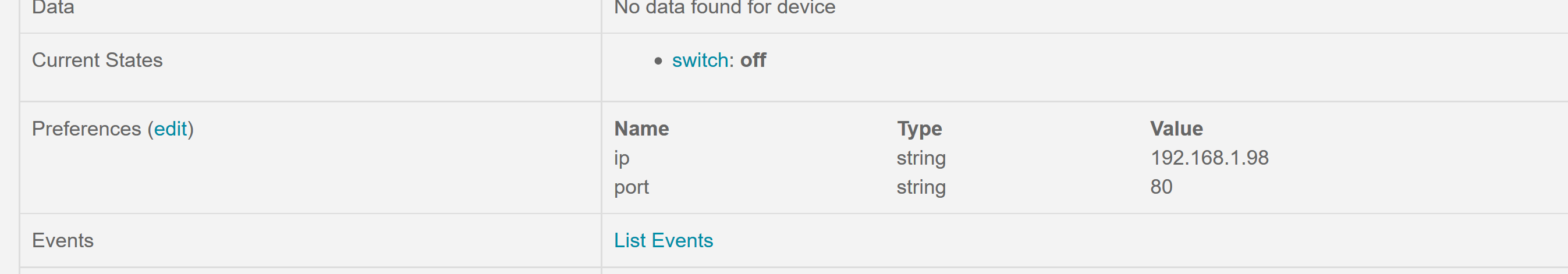

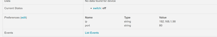

Actually I have found my problem and done it a dozen time since.
So the IP is not put in the code but in the device preferences.
Make sure to change the permission of file in www/cgi-bin/json.cgi to 755 (execute to all group)
I leave line 22 as is?
"input(“ip”, “string”, title:“IP Address”, description: “10.1.1.185”, defaultValue: “10.1.1.185” ,required: true, displayDuringSetup: true)"
Then go into the app on my phone and set the IP there? Do I have that correct?

Just found this post, it works with the Amcrest smart plug which is just another re-branded Kankun. The part I was missing was going under devices selecting the device and then edit preferences. I still get one error on line 78 where this tries to get the status but I can live with that for now.
Previously I was just going into the code and setting the IP address manually there which also worked, but that isn’t the intended way.
