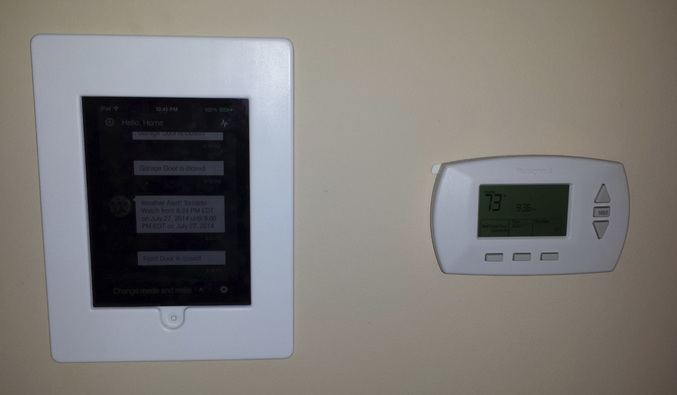

Target has new (non retina) iPad mini’s marked down to $199 this week. I’m gonna grab one or two and wall mount them for touch screen controllers.
Should be a nice clean look.
what is the name of the wall mount? link?
The mount is made by Simple Wall Mount Co: iPad mini mount
You can usually find it $20 cheaper on ebay
