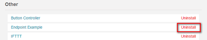

To uninstall, you can find it in the IDE under My Locations > SmartApps > Edit (then scroll to the bottom):
I didn’t see the Endpoint Example SmartApp listed in any categories on my Android devices and I didn’t see it in the Shared Apps section of the IDE, so I’m not sure what’s going on there.
