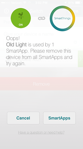

I believe this happened to me today as well. I was under the impression that uninstalling a SmartApp for a single device would not delete that smart app for all of my devices. The only way I could remove a problematic sensor was to uninstall the SmartApp, which in turn destroyed all of my endpoints.
Re-pairing a device involves first deleting a device, which makes it impossible to address it in the same way as before (because the identifier used to reference that device was deleted…not much we can do here). Meaning any API endpoint that did something with that particular device by its id would be affected, but other API endpoints would not.

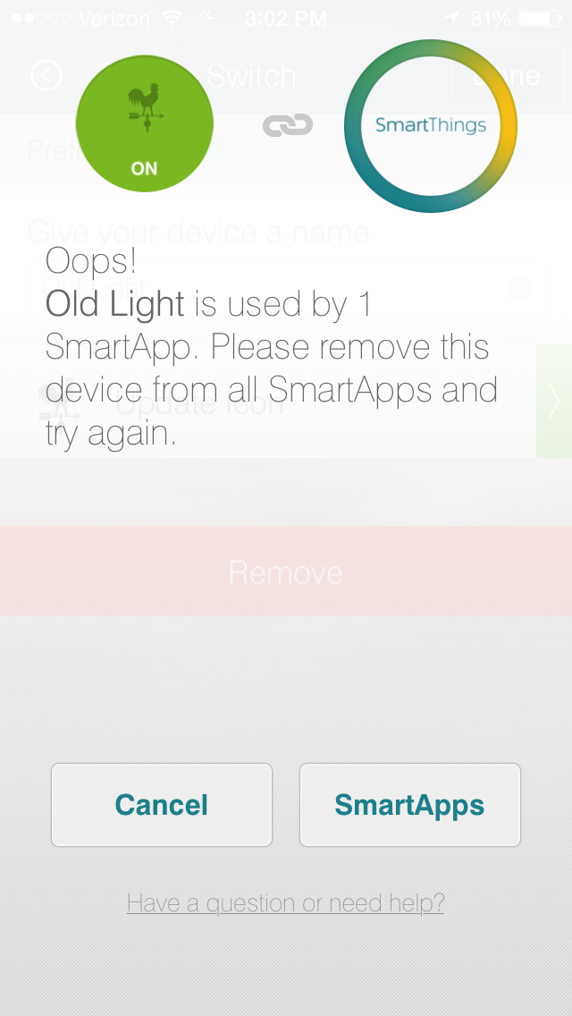

Uninstalling a SmartApp, however, is different. The platform currently forces deselection of devices from SmartApps before allowing deletion as they very well could be integral to the correct functioning of the SmartApp. You aren’t forced to necessarily uninstall the SmartApp, but can instead deselect the device from the SmartApp’s preferences, which would preserve the id’s necessary to keep all API endpoints functioning as before (except any endpoints which reference the deleted device). This can be more complicated when the SmartApp in question is connectable via OAuth, as it is in this case, since it is not visually obvious what the ramifications of uninstalling the SmartApp may be.
The app is called “Endpoint Example”, it is installed for everyone who follows the OAuth flow initiated by http://labs.smartthings.com/exampleOauth.php , and it doesn’t show up in the main Dashboard area of the mobile app after being installed, but can be seen in the web UI at https://graph.api.smartthings.com/ if you click “My Locations”, then “smartapps” (under the location in question).
Yes, that would be my guess. For reference, here is what this would look like from the mobile app perspective. I’m hoping these render correctly and in the order that I am hoping for.
